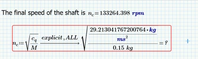

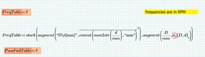

I’m trying to recreate a Mathcad worksheet from a PDF file titled Shaft Bearing Speed. I’m using the exact same commands from the PDF to write it in my own worksheet, but I’m running into multiple errors and mistakes that I can't seem to understand.
I’ve attached both the original PDF, my Mathcad worksheet, and error screenshots for reference. I’d really appreciate any help in figuring out where I might be going wrong.
Thanks in advance. Below are the screenshots of my errors...

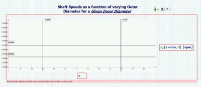

PS: Also, I forgot to mention one more error I had in my sheet, PFA below...

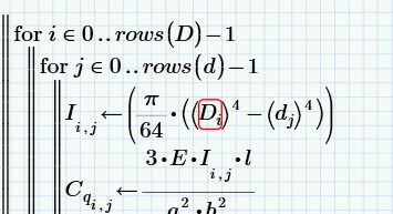

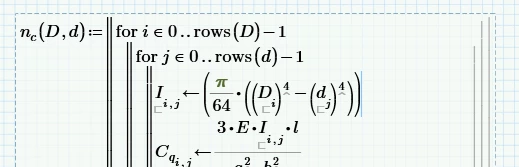

First, the error in your reference to "D" (and small "d") is that you added a subscript "i" which makes it a whole other variable.  You need to use "i" as an index using the open bracket key "[" so that the array "D" is accessed.  Notice the gray notations when you edit the formula:

In the last graph, your dropdown list for small "d" does not actually output any values.  You can see this by typing "d=" right after to confirm it's contents.  Just add the output values in the second column when you edit the dropdown:
