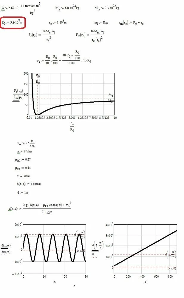

See if the attached helps.
Alan
June 22, 2019
Additionally to what Alan has shown, you should notice, that in the word document there is NOT the ratio F.e/F.m plotted but rather F.e AND F.m.
What you thought is a fraction bar is just kind of a legend, showing which color and line style is used for F.e.
You can add a placeholder for a second plot by typing a comma

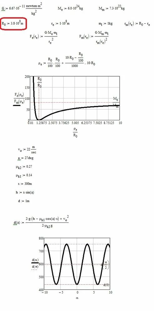

The constant R is confused with a universal physical constant, so it is better to put a subscript, for example .0. See photo:
