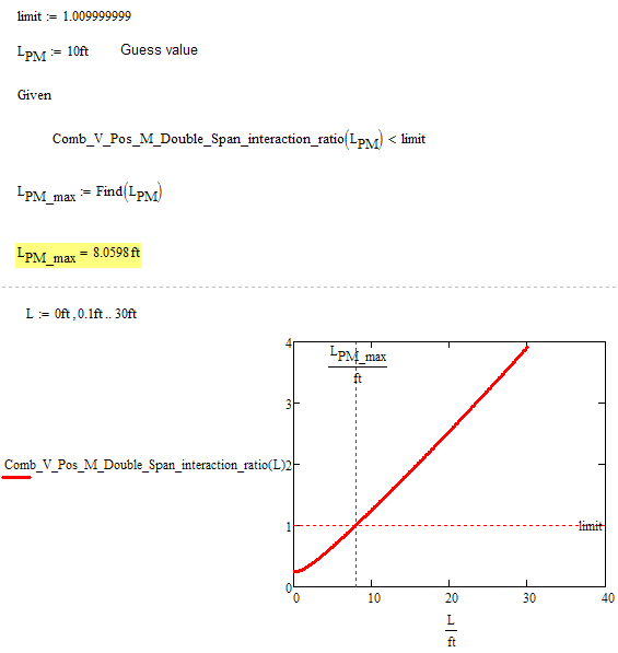

Please scroll down in my sheet until you see the red arrow where i have my question. i am trying to maxamize the value for (Lpm_v) so that the ratio at the bottom does not exceed a certain value which i listed inside my sheet. Thanks!

Create a function, and then maximize it with a constraint using a solve block.
I have plagiarized Richards method and shown a slightly different approach using a standard Given / Find solve block, as I am bored waiting for the WC.
In interesting to see that the two approaches converge to a slightly different result.
In which way is this a maximization?
As the function Comb_V_Pos_etc(L.PM_etc.) is strictly increasing, maximizing Comb or maximizing L.PM is the same.
Here is another slightly different approach using solve and the result is of course the same as Mike's. If you set CTOL to something low as 10^-7 in Richards sheet, his sheet also returns the same value.
And the most elegant in my opinion.
Multiple variations for Sameer to work with.
