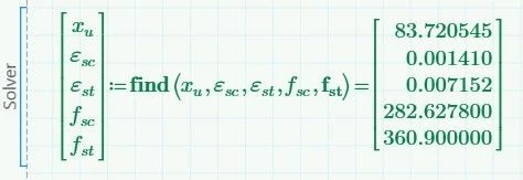

While performing iteration for neutral axis calculation for Doubly Reinforced Concrete beam, I suffered an error.
Kindly help me ASAP.

Hi
Added a line to the stress strain table that means the linterp correctly defines the limits.
Removed the duplicate stress strain calculation.
Renamed the compressive and tension linterp functions by adding c and t to the names

MSRAZA10-MarbleAuthor
thank you.
