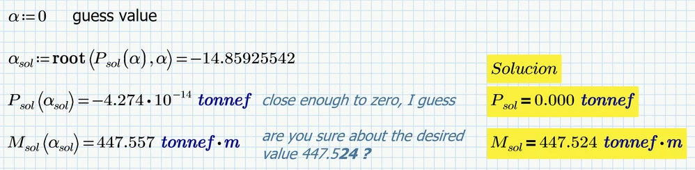

You define a variable alpha at the top and then carry out a series of calculations (mostly using the value of alpha or values ​​derived from it) to calculate a value P.sol at the end.
Now you want to vary alpha in such a way as to obtain a specific value (zero) for P.sol.
It would be nice if you could turn the whole worksheet into a function with argument alpha.
Being able to do something like this is a very long-held wish, previously in Mathcad and now in Prime.
Unfortunately, this wish has not been fulfilled so far.
Therefore, you can only resort to more complicated and complex solutions.
One possibility is to rewrite all calculations that depend on alpha in some way as a function of alpha.
At the end you then have a function P.sol(alpha), the zero of which you can then search for either with the "root" function or with a solution block with "find".

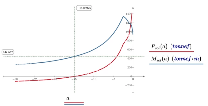

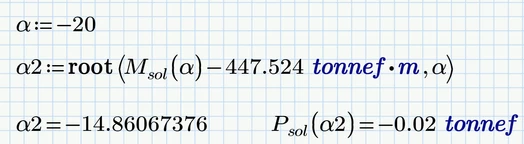

There is a discrepancy concerning your desired value for M.sol.
You can solve for alpha to get that value for M.sol, but then P.sol is farther away from zero:
From the plot it looks like your calculations fail for some intermediate values (the red curve should not look dashed otherwise) - have not investigated any further, though.
