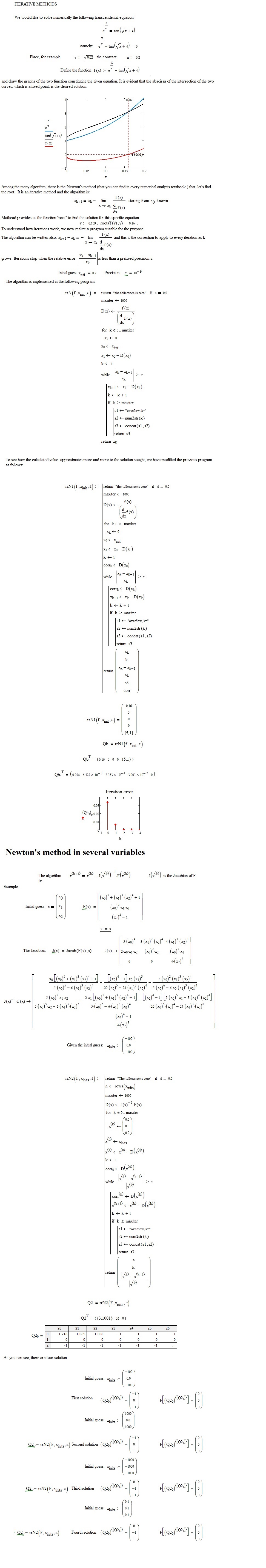

When you know exactly the problem to be solved, everything is smooth. Here is an example:
April 18, 2016
thx for that post. Would it be possible to give me that mathcadfile to understand better?
April 18, 2016
I'm sorry, I had forgotten to attach ....
Greetings F. M.
