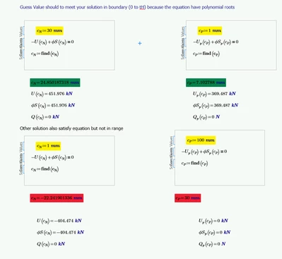

Iterative calculation - trying to find "cN and cP" by iteration (It ranges from 0 to tH).
I had a similar problem but was quite confused to deal with it. It would be great if you can help me solve it.
Please take a look attached file from steps 5 to 9. I'm trying to find "cN and cP" by iteration (It ranges from 0 to tH).
Please help me give a solution for it. Thank you so much.

here is a solution of your problem Retrofit concrete-Slab
Enjoy

I am not clear your problem. but I think you should do it as symbolic solution or the equation consist of (cN, cP and tH ) as variables and then apply equilibrium. to do this no need to iteration, in Mathcad prime have build-in function or other methods to solve that.

Your sheet with a few minor changes see light green:
Will now run in Express, still saved in version 8 but would run in Prime 4.0 Express.
