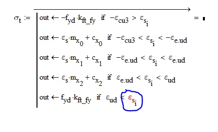

Hi All,
I have written an iterative formula on pg 10 of the attached but cannot work out why it doesn't work. Could someone please give it a second look? Thank you in advance for your time and help.

Need to use functions.  See attached (yellow highlighted alterations.)

If I right-click on your error and trace the error, I discover this:
I can't locate anywhere you define this variable.
Dan34-ParticipantAuthor
Hi Fred,
Thank you for your reply. I am aware of this, but that error won't effect the find fuction on page 10.

Hi Dan
The missing value epsilon spotted by Fred appears in the second equation in the Solve block.
The Solve block will not solve without the value.
