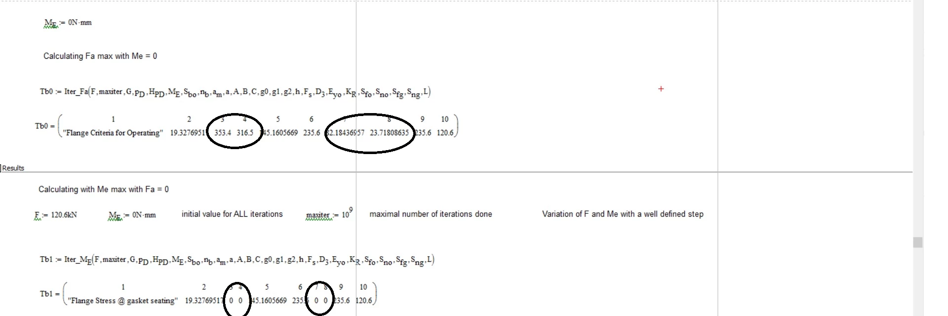

Hey guys,
with the help of Werner i could manage my Iterative Calculation Routine.
Now i need to extend my work.
What i would need:
2 Parameter Variation of "F" and "ME" with a well defined Calculationstep of those 2 parameters.
For Example:
Calculate FAmax with ME=0    ---> Iterationstep for FA = FAmax/40
Calculate MEmax with FA=0 ---> Iterationstep for ME = Memax/40
Now those 2 Iterationsteps should applay to the "2 Parameter Variation"
The Results should then be written in a Matrix so that i can export the results to excel.
I think i only need a small add in to my Programm, what i have now.
Maybe anybody can help me
Calculating the Iterationstep should be possible with my mathcad program as i have now:
Calculate FAmax with ME=0    ---> Iterationstep for FA = Scalingfactor x FAmax
Calculate MEmax with FA=0 ---> Iterationstep for ME = Scalingfactor x MEmax
Scalingfactor should be choosable!
Next step: Mathcad should perform a Iterative Calculation for every combination of thoose steps. (Here Scalingfactor 5 %)
Calculation 1 100% Fa 0% Me     Results
Calculation 2 95% Fa 5% Me      Results
On Page 15 you can see the scalingfactor.
I only would need to know how to write it in Programcode
Best thx!

I already checked of failures. There shouldnd be any. But im not perfect hehe and someone is seeing some things what are not logicaly
Apr 23, 2016 12:07 PM UTC
especially im not 100 percent sure if my conditions are well defined:
Condition_OK_NOK_1 and Condition_OK_NOK_2

Tying to write a 2 Parameter Variation but dont know how
Apr 23, 2016 2:05 PM UTC
not logical Result here

I have given you two examples of iterations, to let you understand that when you work with iterative methods, the program must always do at each iteration (loop) a comparison between the result of the current calculation, and the result of the previous iteration in absolute terms . If the difference is lesser then a predetermined precision, we can say that the solution has been found, otherwise, one must repeat the cycle up to a certain limit, where the program exits from the loop without having found the solution. In your problem, I do not think there are real iterations, since the comparison is made with data values,  there isn't even defined a precision, I believe.
Moreover being your problem fundamentally mechanical, you should place it in the mathcad section devoted to the mechanics.
