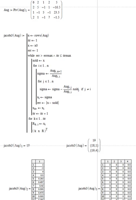

I want to out put all the partial solution of the sys. iteration by iteration in a table (or m x n matrix):
itr     x1    x2    x3    x4
0      ...    ...    ....    ....
1    ....    ....    ....    ....
itr    ....    ....    ....    ....
Also i don't know why in my file does not accept itr->0   instead accept begining from itr->1.  I attached the file.

You've set ORIGIN:=1, this means that indexing in arrays and matrices starts at 1, not 0.
Because you have set ORIGIN to be 1 at the top of your sheet and you use x[itr in your program. itr=0 would mean an invalid array index if ORIGIN=1 and thats exactly what the error messages says.

That one related to the ORIGIN is the minor problem. I take it as it is. Instead, the biggest problem that I still not solved is related to the OUTPUT : iteration vs partial solution of the system. I cannot make the function/file to group all iteration solutions in a table or a matrix.  The file is attached in the previous messaje.
June 11, 2020
It's not clear what you expect as OUTPUT. Please post a picture of what you would like the OUTPUT to be for the illustrated case.
