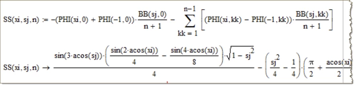

I am trying to calculate the Jacobian (for a Newton Raphson scheme). At this point the problem is simple enough that I can derive it by hand but I want to make sure the two approaches agree (especially since my hand-derived result is nearly singular). What I am doing is not working - I get a "pattern match" error. Worksheet (in MC11) is attached. Thanks for any suggestions.

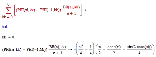

MC14/15 often behaves differently than MC11. We recently discovered in a thread here that this is especially true for the implementation of sums. In MC14/15 the symbolic evaluation of sums is identical to the numeric one. In MC11 the symbolic evaluation of sums follows a bit more  the math standards - a sum from 1 to 0 yields 0, but unfortunately a sum from 1 to -1 should also return 0 but it doesn't. -> Re: Limit value sought - PTC Community

Mathcad 11 doesn't 'know' the Jacob function. I get a symbolic evaluation failure on Gvec:
Tracing back, I see SS fail due to PHI. Noticing that sin(x)/x = sinc(x), try:
then:
and disp will evaluate symbolically as well, but symbolic evaluation of RHS throws another 'must be scalar' problem.

Thanks for taking a look and for your suggestion. I must be doing something wrong because I get "division by zero" when I try to evaluate SS symbolically. The problem seems to be the first term, but it is ok if I evaluate numerically. I can't figure out what I am doing wrong (updated MC 11 worksheet is attached).
RHS is the problem in the Jacobian. When I try to evaluate it symbolically I get the "pattern match exception" error.

Are you using MC15 or MC11?
In MC15 the sum seems to be implemented somewhat differently as in MC11 - maybe this causes the problem.
Anyway, in MC15 it throws the division by zero error when using the sum (at kk=0) while the expression itself works OK.
So maybe this workaround (for n>1) works for you:
