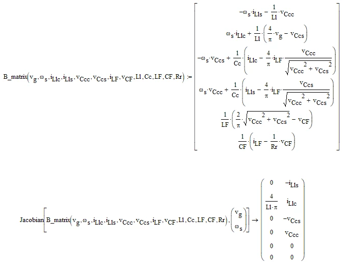

The Jacob() function that Werner shows is not implemented in Mathcad 11. It may have been added in Mathcad 14 or 15.
However former Mathcad Expert Tom Gutman implemented a function that produces the Jacobian, here's an example:
A Mathcad 11 file with all function required to run the Jacobian is attached.

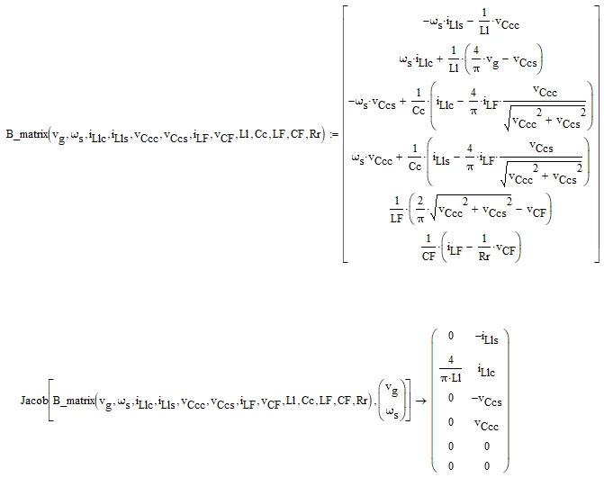

From Mathcads help:
So here's the workaround using your function:

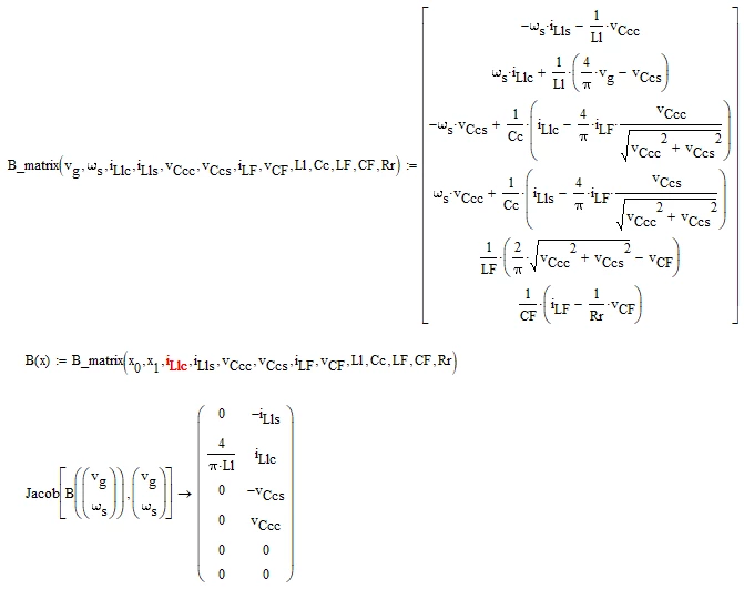

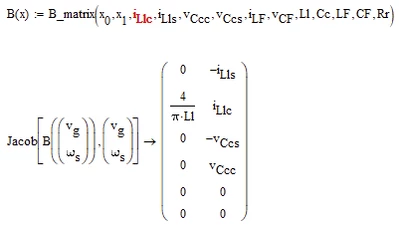

But I don't mean in Mathcad 15, but in Mathcad 11.
In Mathcad 15 I know it works.
Mathcad 15:

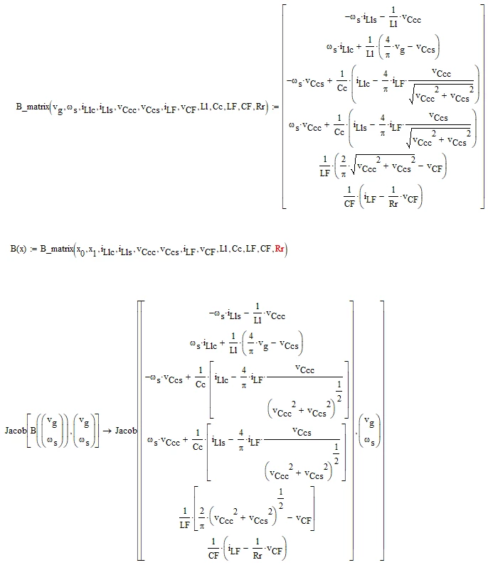

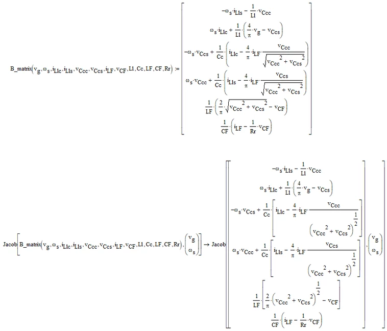

Mathcad 11:
Should it have the same result in Mathcad 11 as in Mathcad 15 with the same syntax?
Or is it done differently in Mathcad 11?
