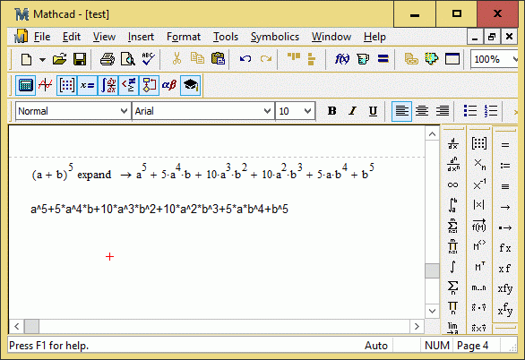

September 8, 2016

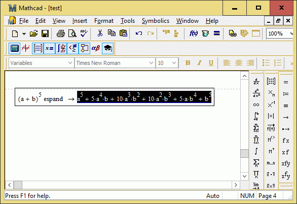

Hi. This is a workaround, for some cases (for example, without radicals).
Copy the symbolic answer

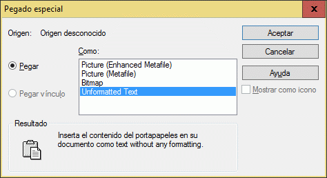

Right click in the paper and choose "Past Special"
Sometimes the option "Unformated text" is avaible
This is the result:
Best regards.
