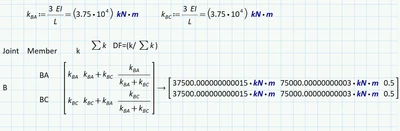

keepin variables in my Calcs - Mathcad prime 10.0
I want to
keep EI as EI in my calculations, as EI was defined previously. wondering if I can do that, and then I also want to extract 0.5 values out, because these are my Distribution factors. so I want to be able to type DF_BA = 0.5.

Can you please include your sheet so it is possible to show you.
Include DF:= before the matrix.  then DF_BA:=DF[0,2

I will attach it here, when you look at my sheet I also want to set up the next matrix you will I have started working on it. I want to write the global coordinates and leave - signs as is even if i ^2 it. it will make sense in my sheet. I am new to mathcad so I am still learning this.

Same Sceanrio I want to keep AE outside my matrix as is and not get calculated into my matrix

In the solve block you have four equations and five variables to find.  Solve cannot do this you need five equations.
