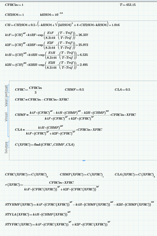

Hi, I'm new on the forum and inexperienced with Mathcad Prime 3, so I need help. In the attached sheet I just wrote the kinetic model for a CSTR, which is a simple system of
2 algebric equations. There are lots of parameters that are fixed and one, XFRC (conversione of the reagent), that must change because I have to plot the solution of the system
with respect to that parameter. How can I do that? Thanks and sorry if my english is not perfect
May 25, 2016
See please the attach and the picture
15 replies

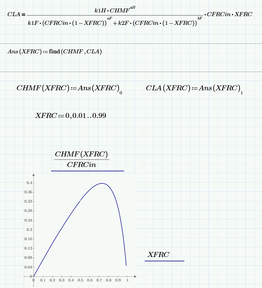

Please post PDF or XPS version of your Mathcad Prime worksheet.
May 25, 2016
May 25, 2016
Thanks, this is perfect! By the way this is a part of a study about kinetic, maybe I'll ask for some more help later! Thanks again to all of you

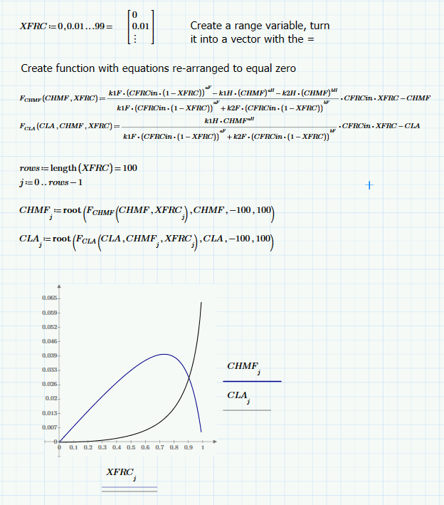

I think Valery's method is probably best.  But here is an alternate version that gets rid of the solver.  I think it works.
May 25, 2016
Thank a lot to you too !!

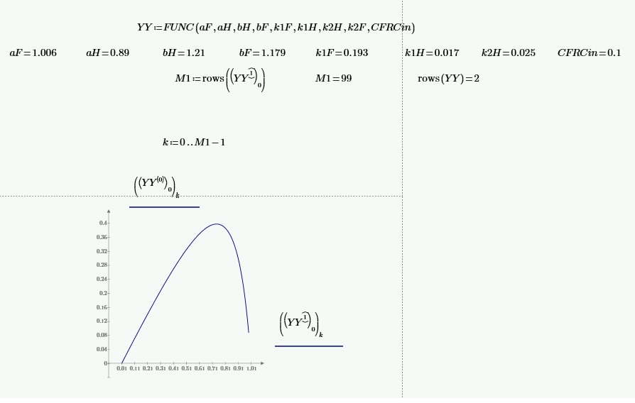

Hello again, my work proceeds but now I encountered another problem, related to my low programming skills. I am sure that you can solve it in a moment. In the image you can see a solve block for a single CSTR reactor, I need to iterate the soluzion for N CSTR reactors in series. This is banal on paper, because all you need to do is to use the solution of the first CSTR as input for the second and so on. So I tried to make a "for loop", but I found that solve blocks cannot go into programming area. How can I solve it?
P.S. of course the conversion XFRC will be referred to the entire series of reactors.Immagine.png
May 29, 2016
You do not need to use the solve block inside a cycle - You need to use in the cycle a function created in the solve block.

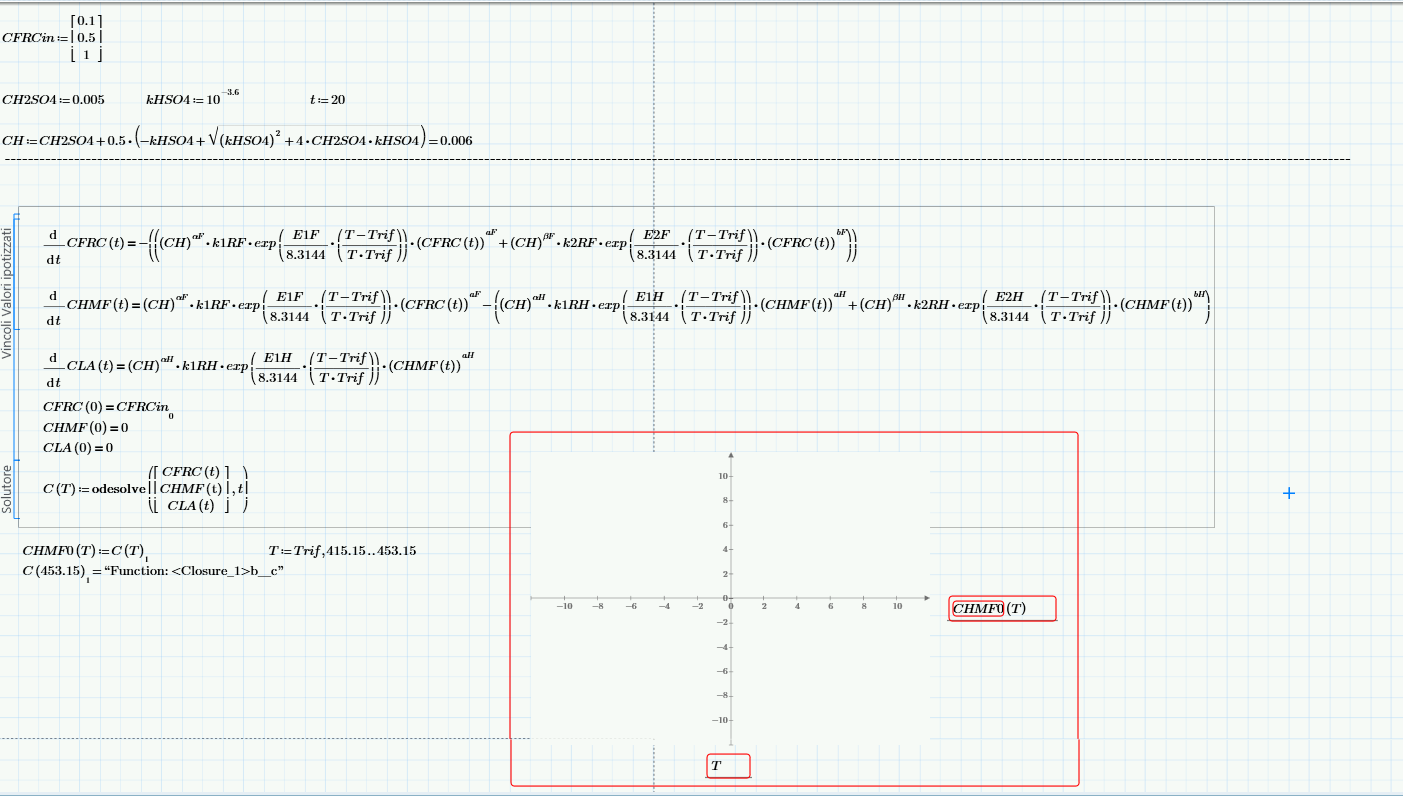

Another question - I hope this will be the last .
I need to graph the solution of the ode system vs temperature. I do not care about the trend vs time, I need only the output (after integration time) at various temperatures. How can I graph it? I'm probably wrong in assigning arguments of the function...
May 30, 2016
Edit: I just solved using: CHMF0(T):=C(T)(t). I think this is ok for my purpose
