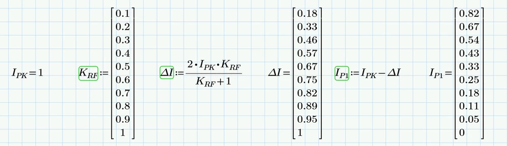

I have two screenshots below, one of which shows the calculations I've done for KRF and Delta I.

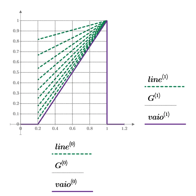

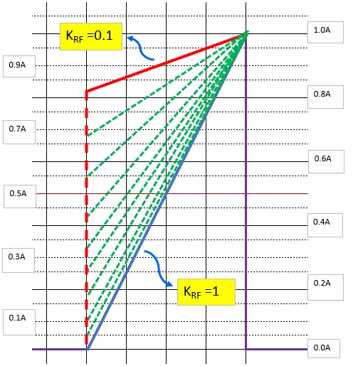

螢幕擷取畫面 2023-10-03 120926.png I would like to use this data to create a chart on another screenshot. Could you please teach me how to plot it?

ttokoroAnswer
Oct 3, 2023 5:35 AM UTC
t.t.
ttokoro
ttokoro21-Topaz IAnswer
