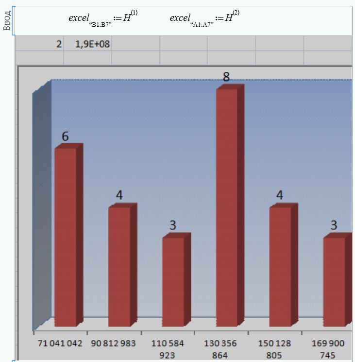

May 10, 2016
We can insert Excel-sheet in Mathcad
