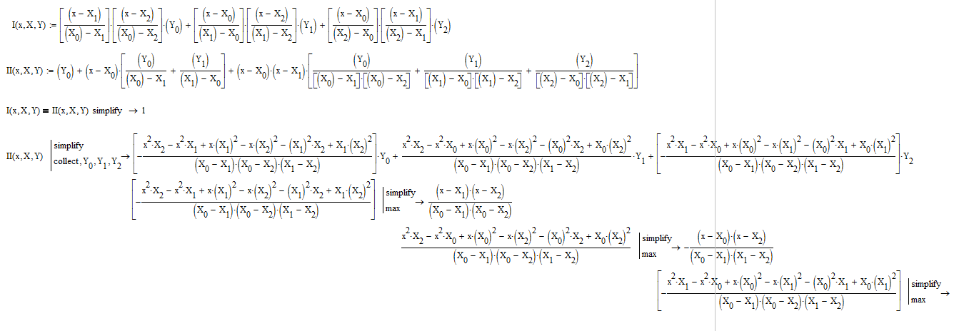

  Hello Everyone.
Is there a way to transform mutually form I and form II ?
       Thanks in advance for your time and help.
             Regards.

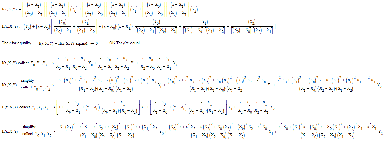

Does this help?

    Many thanks for your time and help, Luc. It's very helpful to me. ( Transform from Form II to Form I ).
   But I still have a query : Would Its Extension Be True ?
        Best Regards.
