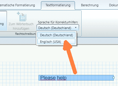

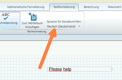

I have a german installation of Prime 7. As I work for an international company, we use english in our documents. When I input text, the spell check always switches to german. So I have to manually format every text to english. How can I force MathCad to spell check in english as  default?

I am using a German installation of Prime, too, and can confirm the problem. The language may be set to "English" even in a template file, but whenever a new text region is created and I start to type, it automatically switches back to  "German" so it must be manually set to "English" again and this has to be done for every single text region created. Very annoying! I see no way to change this behaviour but as I generally found the Prime spell checker less helpful I turned it off by default (and thankfully this is working without having to turn it off for every file individually).

One hint from me, if you want to change everything to a certain language, click on an empty place inside the document (outside of a chapter), hit ctrl-A (for select all) and format it to "english".

One hint from me, if you want to change everything to a certain language, click on an empty place i the spell checknside the document (outside of a chapter), hit ctrl-A (for select all) and format it to "english".
Thanks. That should work at least for already created Text regions. New text regions still would default to German, though. But as I wrote I usually have the spell check disabled anyway. Maybe just because I am used to do so so in real Mathcad (version 15 and below).
