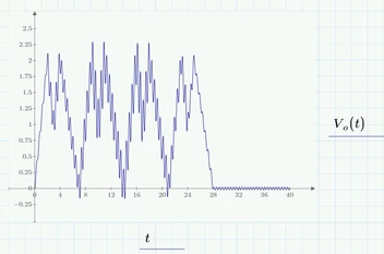

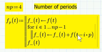

Basically this is the function you may be looking for
and this is the result you get at the end of your sheet
