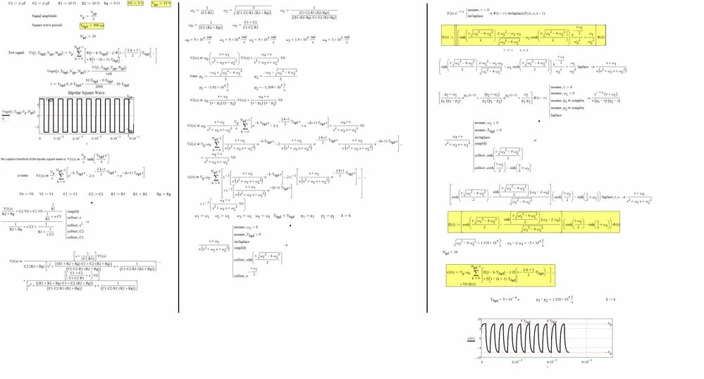

I'm trying to make a template that can be used for circuit analysing using Laplace transform.
Here, we have a second order RC lowpass filter and I want to use an repetitive input signal.
In V2(s) equation, where we have the input voltage I would like to use the f(s) input function or even better g(s) repetitive input function.

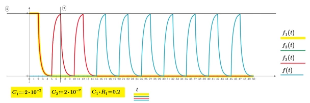

In the file attached you can see that I have 3 plots: one with input voltage as a constant, where it works and the plot is ok, and another two using f(s) and g(s), where it returns this error "Replace complex values and NaNs by real numbers".
What can be improved in order to use the repetitive s domain function?
Mathcad using is Prime 4 and you cand find attached a .pdf too.
Thanks.

Try to evaluate V.2_f for, lets say, t=10^-5, numerically!
You run into an overflow error - the calculation of a subexpression yields a result greater than the numerical limit of 10^307 and throws an error.

Although realized with mathcad15, you can rewrite it in Prime. You should proceed in this way:
February 23, 2019
I enclose the Mathcad 15 worksheet related to your problem and which you can easily import into Prime. Learn the art and put it aside...

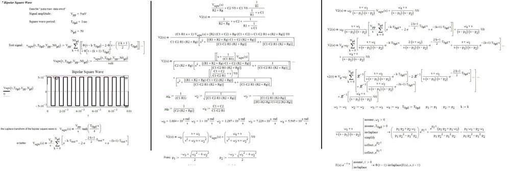

Hi @-MFra-,
If i rewrite your input signal, when I try to plot returns the following error: "This value must be a real number"
LE: I solved this step, I will go on and return with news.
