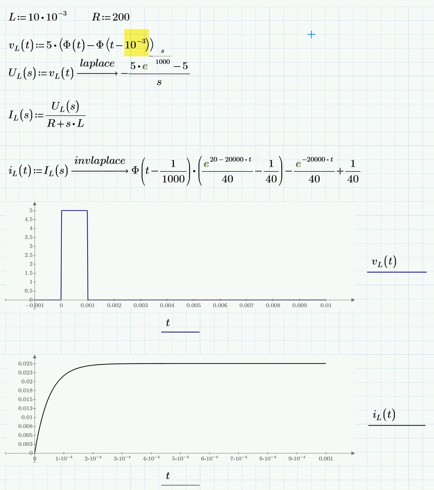

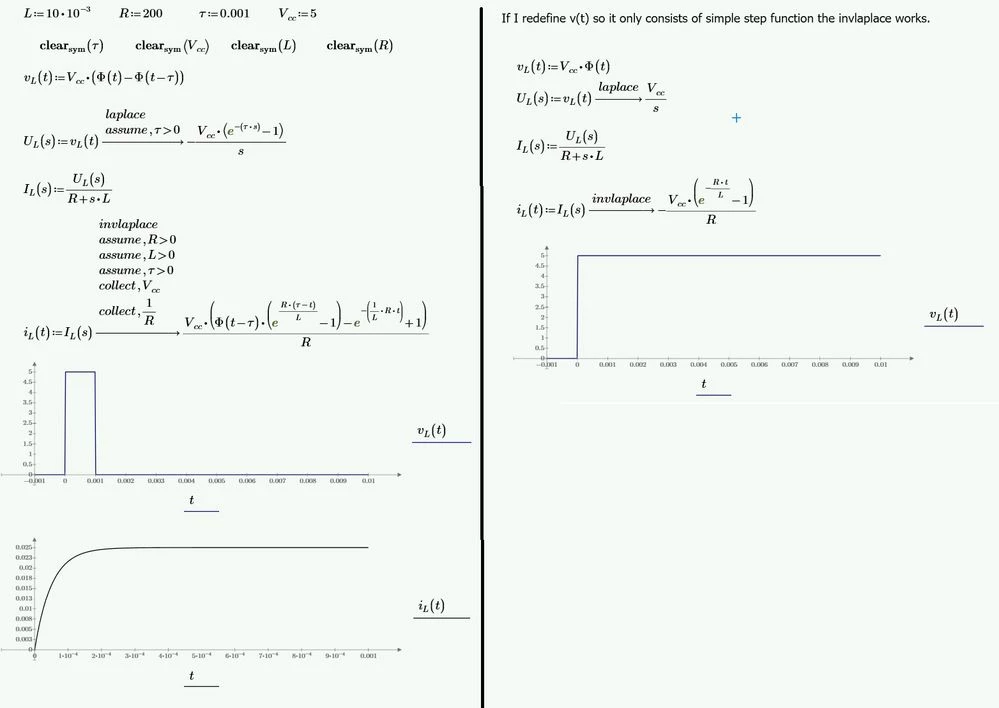

I have started to use Mathcad a bit for circuit analysis with laplace transform. However, often the invlaplace does not give the output i expect.
Am i doing something wrong?
I have attached a worksheet where i want to plot iL(t). However cant get it to work.
If i redefine the step function i am using (only using simple step) it works...... i need to be able to analyze step functions...
Would be great to get some input...
Best regards Kanka

No, Prime is doing wrong. It should work, but the symbolics (=muPad) in Mathcad is sure not state of the art and comparable with Maple or Mathematica 😞
Whenever you use a decimal point in conjunction with symbolics, the symbolics switches in some sort of numerics mode and calculations like equations solving or invlaplace might fail because of this.
I fear that there is not much you can do other than avoiding float numbers:

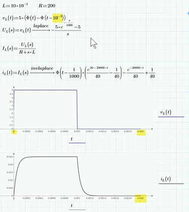

Yes, thats the same outcome as in the OPs sheet. I had not changed the plot limits he had set

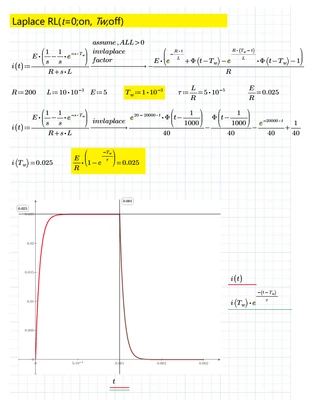

...So it's more beautiful .....

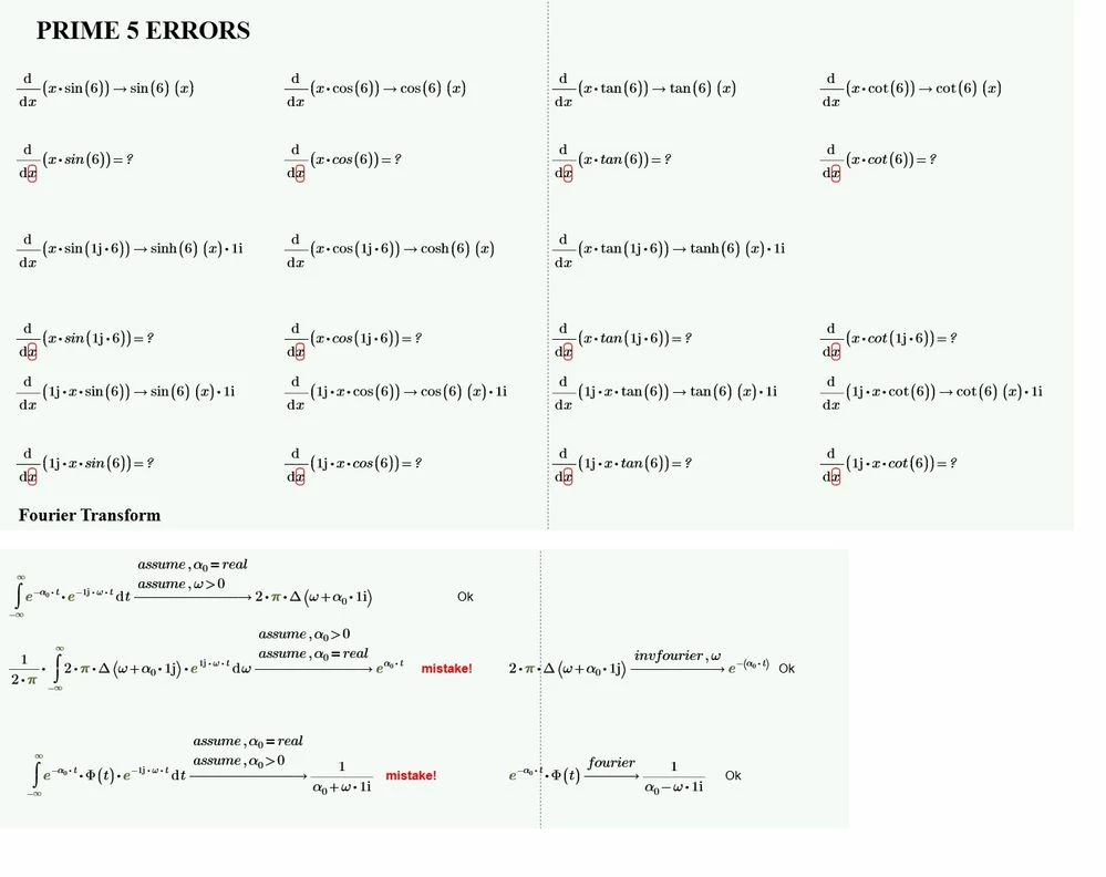

The following errors of Prime and mathcad 15 have been known for a long time:
