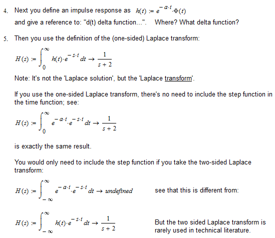

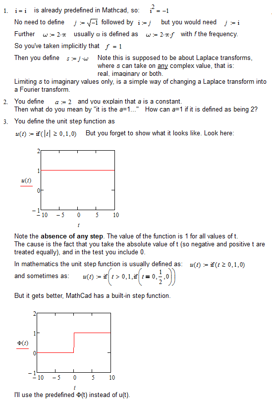

I have a few comments on, and problems with your document,
centered around your elaboration of "Example 3.9":

I corrected your item numbers 1,2,3, and 4.
I knew the built in function exited, was careless on the u(t) because I was trying to make it a created function rather than use the built-in.
Check the rest of the file.
I will post an updated file - Rev 1 later.
