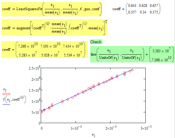

Hello folks,
does anybody understand why this leastsquaresfit does not compute for this plain problem?
Thanks in advance
Raiko

It's a scaling problem. I would expect changing TOL or CTOL would fix it (this would work for genfit or minerr), but it seems that does not work.
Your guess value for the slope was also a long way off.

Well yes, the guess values where indeed far off, however I've had success with even wilder guess values for linear problems.
Raiko
Yes, the guess value was not the fundamental problem. That was just an additional observation
Here's a possible way to automate the scaling and rescaling. It should also not be necessary to deal with "UntisOf" because "mean" would take care of the units.
Is there a better, shorter way to do the rescaling?
We have to multiply the whole 2 x 3 marix with mean(s.1) (which is easy to achieve) and then only the first row has to be divided by mean(e.1).
EDIT: I just notice that the rescaling of coeff needs a unit strip off, which should be easy to accomplish. The reason ist that we cannot have different dimensions in a matrix, which would be the case, if e.1 is not dimensionless.
Its interesting that "line", which also should use a least square fit, I guess, dies not show this scaling problem.
Regards, Werner

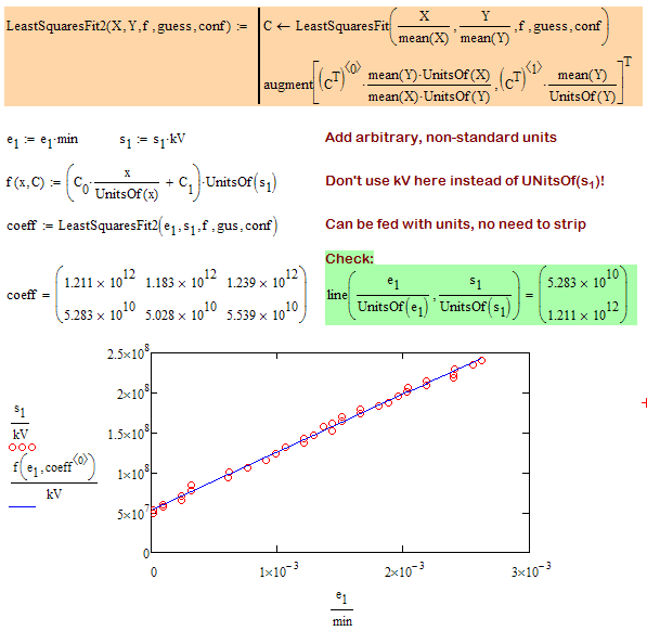

Here is the modified sheet using an allpurpose, unit-aware LeastSquareFit routine which also should not show those scaling problems.
I just noticed that I never changed your original guess vector. It really seems not to matter that its way off.
Regards, Werner

Hello Werner,
neat function!
