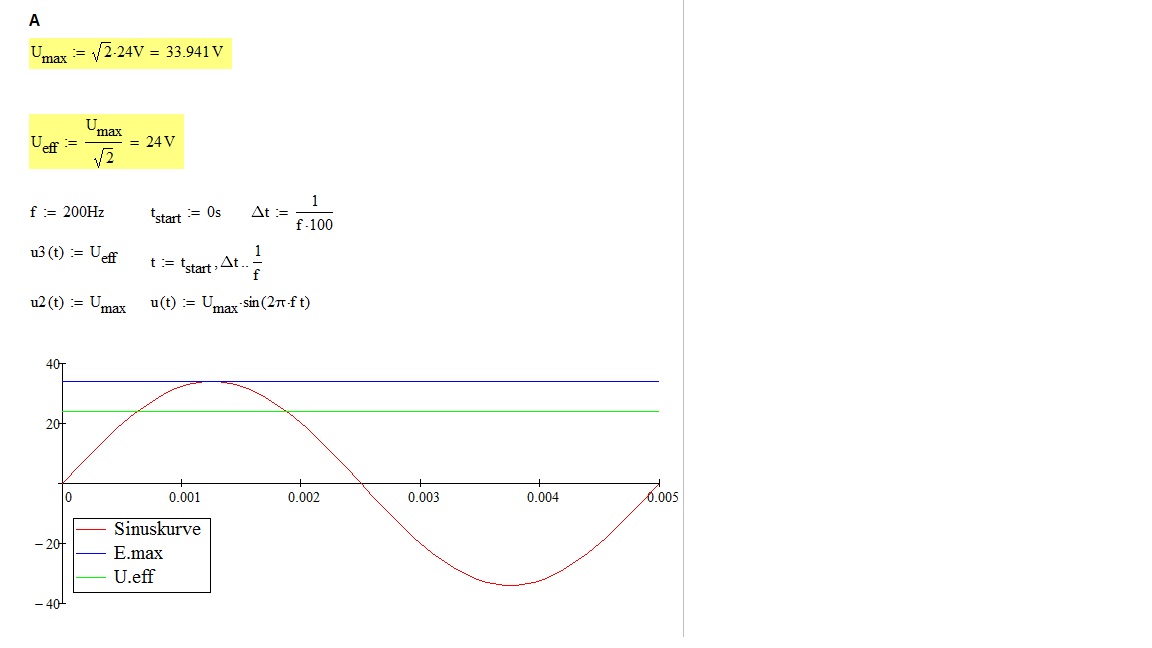

How do i leave out part of a sinus curve? How do i write it if, i were supposed to leave out the first 45° of this. I have MathCad 14.

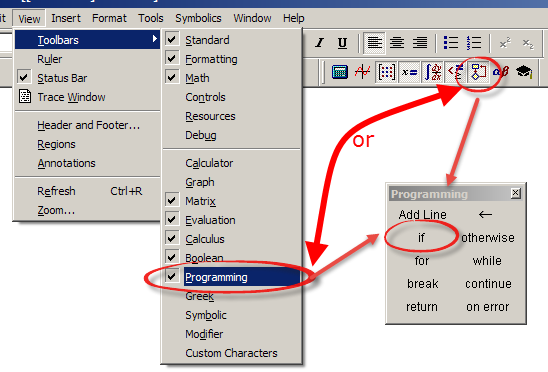

You may define you function either by using the if-statement (Programming palette) or the if() function. Set the function to zero for values of t smaller than pi/4 or set it to NaN if you don't want to see anything in that range.

November 2, 2015
I'm not sure I understand it.  Is there anything I should do different in the one i have done? Or should i do it all in another way? I can't find Programming palette.
EDIT: Couldn't see the added files before. I think i understand it now. Thanks a lot

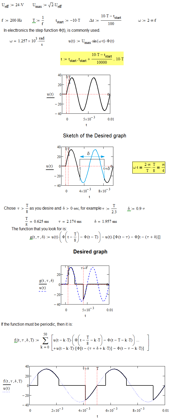

      Hi Tommi Lauridsen! I think I have the answer to your problem. Open the attached file with Mathcad 15 or see below.
The range of the variable in your description is not correct.
                                                                         finally

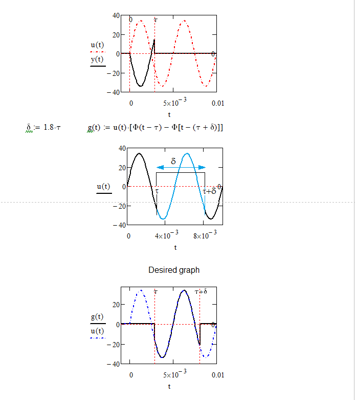

The second picture could be this  if you exchange the two step function as follows:

I will look into it tomorrow.. But I'm not sure i have got the right answer yet. If i take to hole cycles(2*T) and I would like leave out the first 45° degrees of each? Like in the first picturer Werner posted? Is that possible somehow? I'm thinking that you somehow can you radians?
Sorry if I misunderstand any of your replys.
November 2, 2015
Hello! You can choose the interval that you prefer simply varying tau and delta .

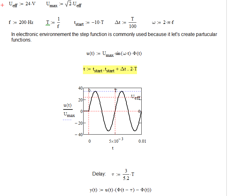

Nice sheet, FM.
Here's another option for the periodic case that also doesn't plot the 'missing' points.
