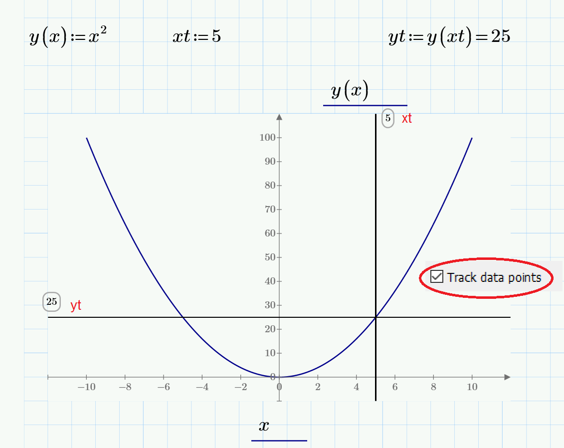

March 15, 2017
Prime needs at the first line this option from Mathcad 15.
Users can move horizontal or vertical marker and see cross-hair with two values on the curve!
Now we can change the xt value an see it.

March 15, 2017
Thanks Valery.  The seamless way that MathCAD 15 does this is a very useful and heavily used feature.
Getting rid of this in Prime is a major reason that my coworkers do not want to switch away from 15.
