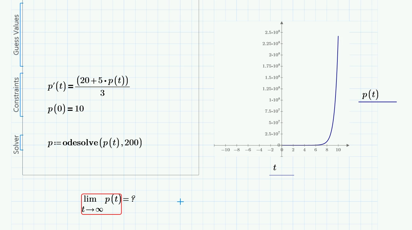

I have problem with Lim and differential equation.
1. How to get Lim (variant t) for function p(t): as attachment picture?
2. Can we get symbolic formula for function p(t)?

1. You can use lim only with symbolic expressions and evaluations (it will not work numerically).
2. Prime does not solve differential equation symbolically

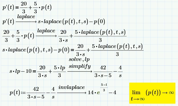

For a symbolic solution, you can use Laplace transform.
