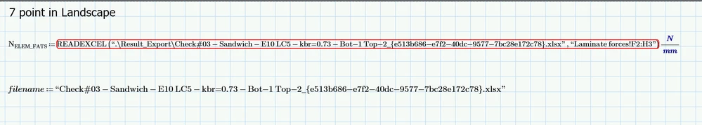

I’ve attached an example. The filename is quite long because it’s generated automatically by a program. Renaming it would be the simplest solution, but that would break my process—so I need to work with it as it is.
If I define the filename separately, concatenate it, and adjust the font size, I can make it work, but that feels like unnecessary trial and error. Ideally, I’d like to assign the text to a variable and have it wrap automatically.

Another method, which probably won't work with your flow, is to change the page orientation to Landscape:

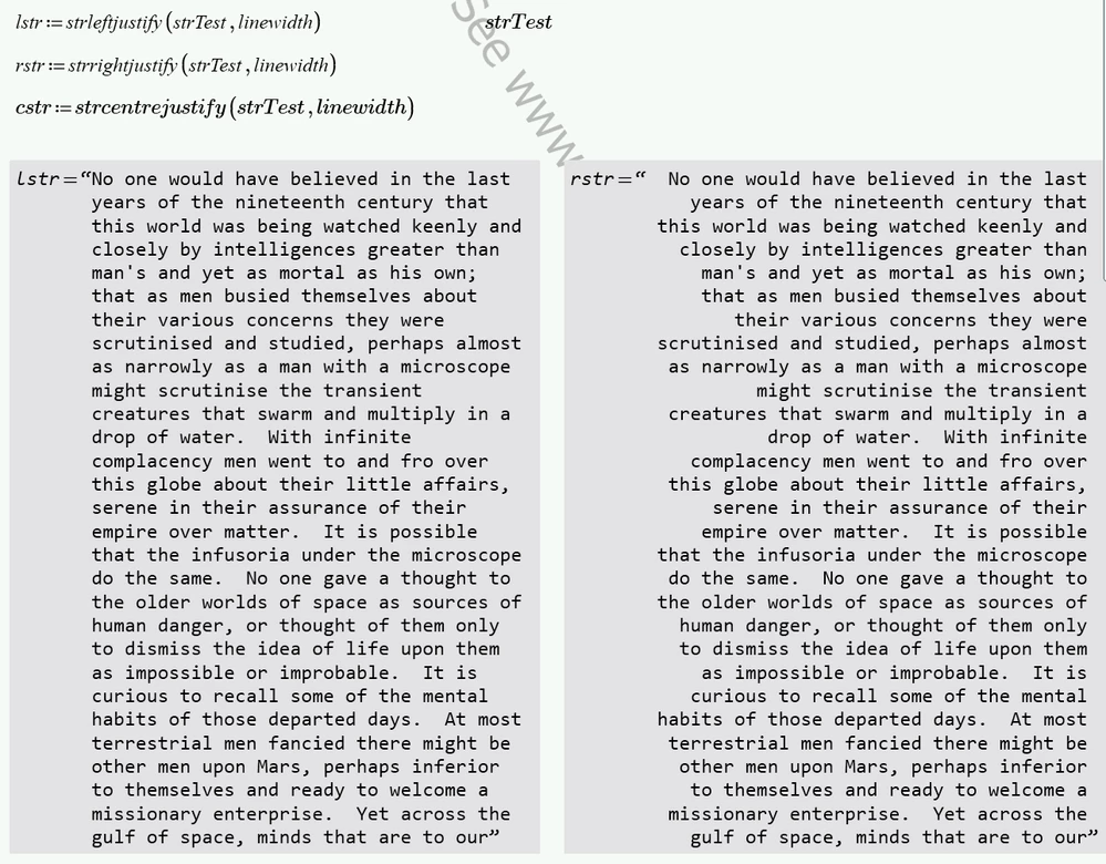

Another option is to write/borrow/steal a set of functions that will break up the filename for you.  For example, it is possible to create a string variable that inserts a line break character (codepoint 133, IIRC), and then display that.  Here's an example that fits a very long string to a 40-character width and left and right justifies the resulting string (there are additional functions that centre and fully justify the string, as well).
