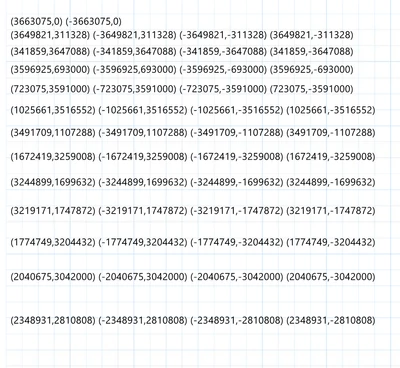

Hello.
I am unable to find any way to change line spacing in text box/block. Is it possible? How?

Add 1pt line for spacing.

The workaround suggested by ttokoro (manually adding blank lines with a very tiny font size to simulate larger line spacing) will also mean that you cannot use the automatic line break feature any more, which may be a problem if you later decide to resize a text box.
February 16, 2021
Thanks. I might try to use hidden 1pt lines for shorter documents and assignments. I am required to use different line spacing.
