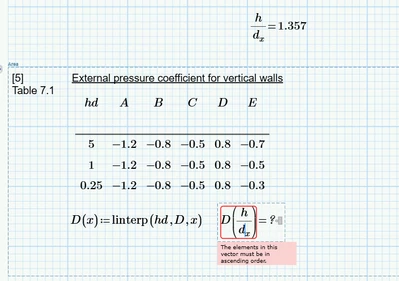

As shown above when I tried to linear interpolate the D values corresponding to h/d values of column 1. It is showing following error, Kindly help me.

Isn't the error message self-explanatory?
The elements of the first argument vector must be in ascending order. your vector is in DEscending  order, so you have to resort it (and of  course also vector D (which contains constant values anyway.
What do you expect your function to return? Anything else than 0.8 for any input value?
Furthermore you should not name the function and the vector the same (D).

Thank you for your help, It worked.
