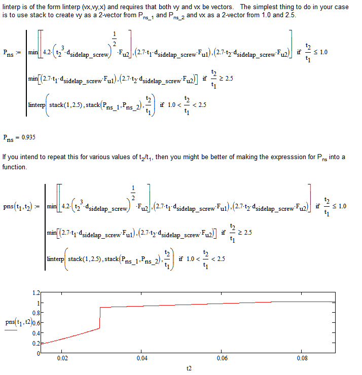

How can i use the linear interpolation function in the attached MC 15 sheet?
See image below.
Stuart
