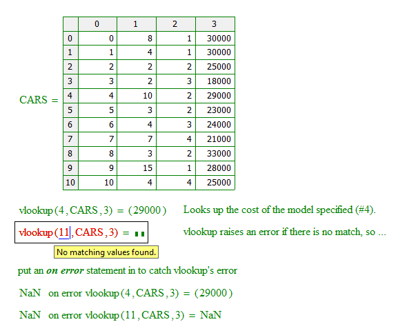

Hey.. I am trying to use VLOOPUP function... my problem is defining the function..which gives value of zero when the VLOOPUP function is not able to find an exact match... how to do that.............................
23-Emerald V
Use Mathcad's "on error" programming construct to trap the error that vlookup raises when it can't find a match.  Then have "on error" return whatever result you want.  I've used NaN in the example below, but you simply replace it with 0 to get the result you want.
Stuart
