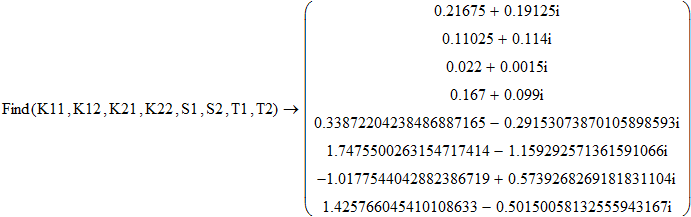

I am new to PTC / Mathcad V15.0 but am trying to use this great tool effeciently.  For my job I have solved a problem which involves 8 equations and 8 unknowns.  I have successfully arranged my equations to arrive at the correct solve block answers using the command Find as shown below:
The output naturally provides numeric (in this case...complex) solutions.  Here is where I need help.  With the results I need to conduct additional calculations but it does not seem that Mathcad does not recognize the value of each variable...such as K11 = 0.21675 + 0.19125i.   Must I define these variables manually after the solve block or is there a command which  will link the output to its respective variable.  I plan on using the 8Eqnt/8Ukn solve block to solve for different givens...however, this currently means I need to manually set the correct result for each of the 8 solved variables such as K11:= 0.21675 + 0.19125i.

Hi Jim,
We need the relative worksheet so that we can give you some advice.
April 14, 2017
Sorry.  I should have included initially.  I attached to my original post.

But anyway, for whatever it may be worth, here is a slightly more direct approach.
Its not necessary to use the vector in the find command, I just thought it would save some space.

Yes, thats one of the things they have broken. A solve block cannot be evaluated symbolically, Thats quite a miss.
But in this case we should be able to find a similar solution using numeric evaluation only. Its just necessary to provide non-real guess values for the searched for variables.
