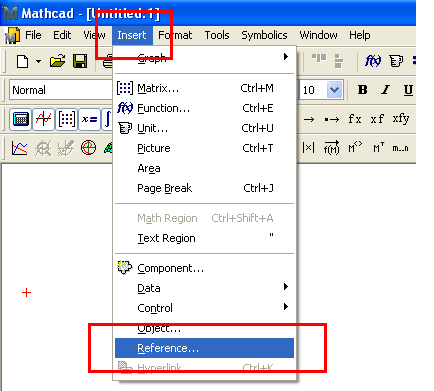

In main menu select "Insert" -> "Reference" and then choose your worksheet with prepared calculation:

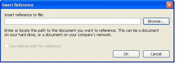

One more picture:
http://twt.mpei.ac.ru/ochkov/Mathcad_12/1_21_Reference.png

I tried this and it inserts a link that opens up the other sheet I wish to use, but is there away to transfer all the variables from on sheet to another doing something something similar to this and without having to copy paste the whole thing? I'm using M 15 by the way
