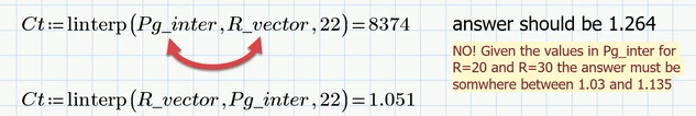

Working on linear interpolation of a coefficient from a 7x4 matrix, utilizing x and y axis ranges, Pg_Vector and R_vector respectively.
From the first part of the linterp function worked perfectly for the x-axis  solutions, but the second time working on y-axis returns an incorrect answer.
See attached Prime 10 file.
May 23, 2024 3:15 PM UTC
You used the wrong order for the two data vectors
May 23, 2024 3:24 PM UTC
Thanks, missed the possibility that the operation would act differently when pulling out horizontal and vertical vectors, requiring reversal of the data and range vectors.

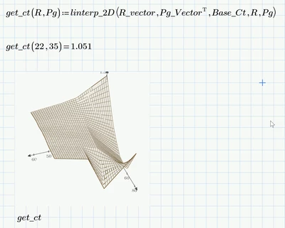

May 23, 2024 3:33 PM UTC
Maybe you are looking for some multidimensional interpolation functions:
Prime 10 file attached
