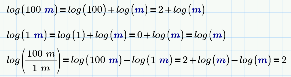

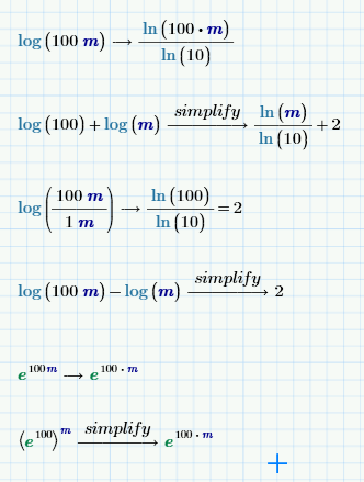

June 17, 2017
if we have e^(C*100m) and C is of nature of 1/m in dimension then of course.
if we have only e^(C*100m) and only ln(100m), then we have totally bullshit and the revelation is near.
if we aren't able to see this, we are blind and the revelation has come.
June 17, 2017
Can you show this with Mathcad
As with log

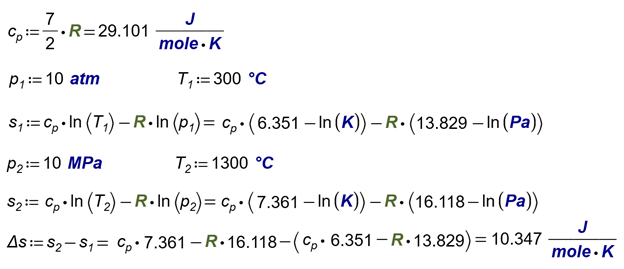

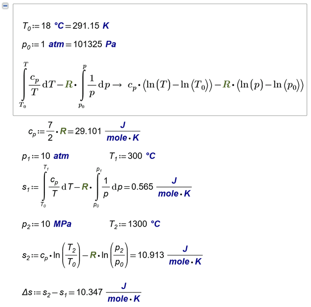

June 21, 2017
Two solution - entropy
1-st
2-d
