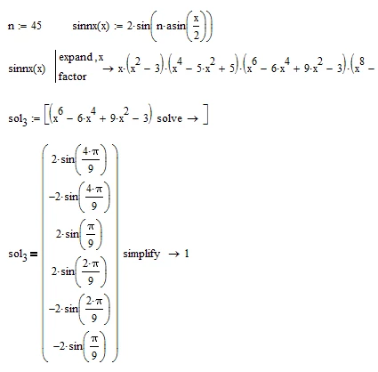

MathCad 14 factored the function sinx(x). It is known from other investigations that this function has only real zeros. If you now look for the zeros of each factor (the terms are in parentheses), then MathCad calculates complex zeros that cannot be simplified. Where is the saw stuck here 😉 .
Kind regards, Alfred Flasshaar

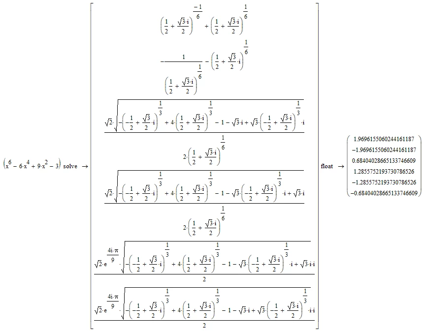

In the sheet you attached I can find no attempts to find any zeros!
Mathcad often displays real numbers using expressions with the imaginary unit. Nonetheless those expressions are real numbers as you can confirm by using "float" or numeric evaluation:
Actually the first solution
is equivalent to
but I have no algebraic expression without using the imaginary unit at hand.

The saw is stuck at numerical precision when calculating numerical results, even from symbolic expressions. I get all real results, sometimes with an imaginary part that is below numerical precision. That is: where the real part is in the order of 1, the imaginary part is in the order of 10^-19  to 10^-21. You can/should discard such imaginary parts.
is equivalent to

Yes, but Mathcad is just applying the elementary equation
neither algebraic nor avoiding the imaginary unit.
In MC15 it something similar can be achieved with
I am not sure if a simple pure algebraic expression could be found.

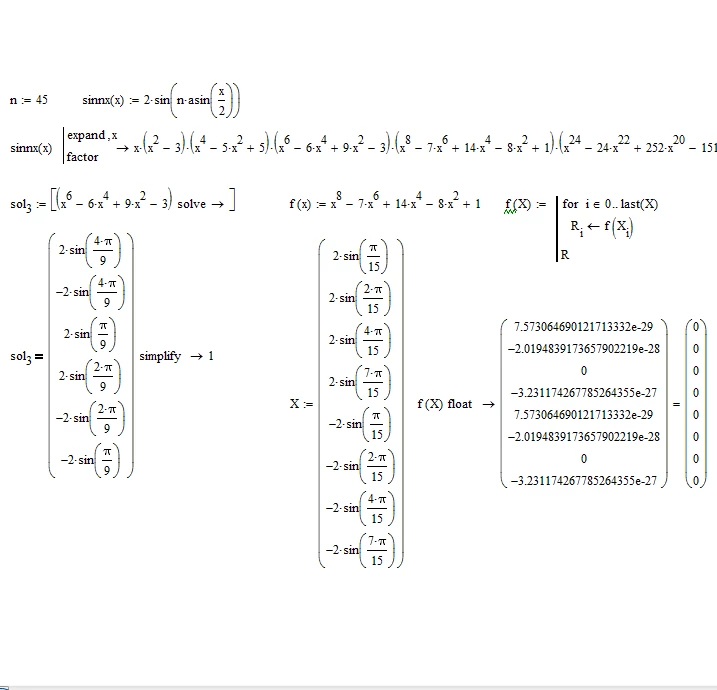

20-Turquoise
It seems to be:
Best Regards.
