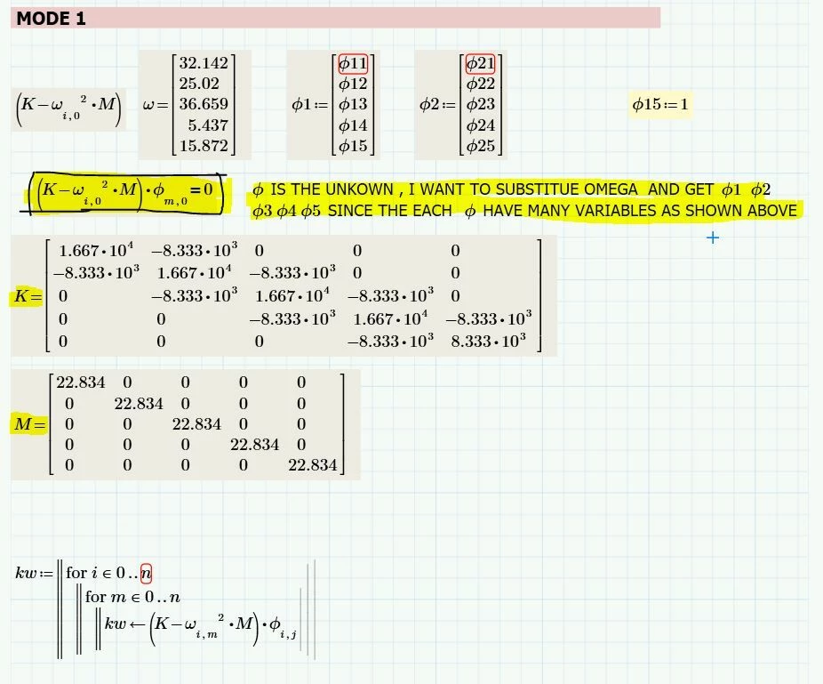

Sorry, I do not understand your problem. Give please more information!
August 24, 2018

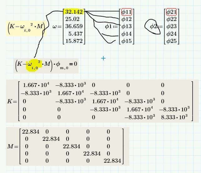

I WRITE THE COMMENT AS SHOWN IN ATTACHED FIGURE
August 24, 2018
Still not clear what you are looking for.

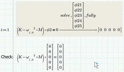

You are talking of 5 different homogenous systems (depending on which component of omega you use) and the solution would be trivially the null vector in any case !
A homogenous system always will have either the null vector as its only solution, or there is an infinite number of solutions depending on one ore more parameters.
Why do you think that Phi15=1 ?
BTW, do you have a problem with the caps lock key on your computer?
August 25, 2018

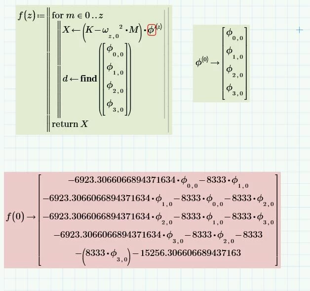

i solved the problem , but now i want to solve equation as shown in figure
i want to get phi
August 26, 2018
The functions you are looking for are genvecs(K,M) for phi and genvals(K,M) for omega squared.
