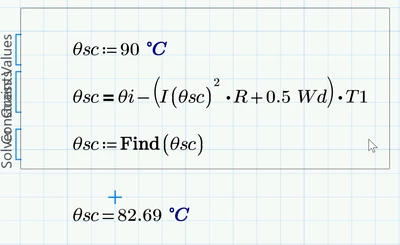

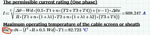

As now, in midst preparing the power cable ampacity calculation, somehow, required loop calculation process at the end section. Here it goes.
1) Assume the θsc (pic 1)
2) Then several calculation in the middle to get the ampacity value. (pic 2)
3) Once current (I) value obtained, the θsc required to be calculated as per red mark above.
4) When θsc calculated, it required to be linked and to be used as input in item (1) above (and so on until) the θsc in item 1 and item 2 comes with 0 difference.
5) Calculation sheet as attached.
Thanks.

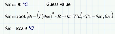

OK, there are four calculations which depend on thetasc and you have to turn these into functons of thetasc.
Then you can use either a solve block or the "root" function to do the iterations for you:
Hope that the attached sheet helps.
Remarks:
The root function can also be used without providing a range (I used 9°C to 90°C) but using a guess value:
And her for completeness sake how to do it using a solve block
6 replies

I think you are missing a term 'v', to be multiplied with each of the two T4 in your formula for I.
In order for an iteration you have to make clear which items depend on I and on theta_sc,
Already checked and the formula seem correct.

Werner_E25-Diamond IAnswer
Remarks:
