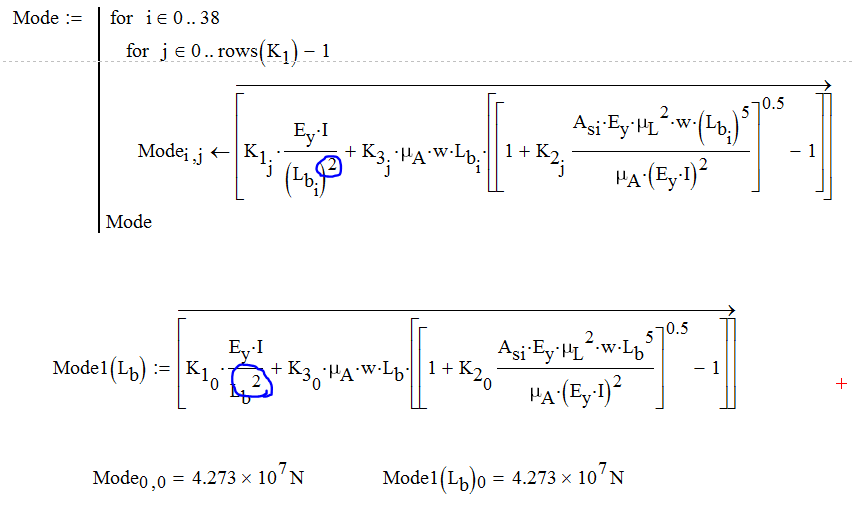

I was trying to make a loop function after your modification.
Without loop function, I am getting the answer where as same formula with loop function not giving me the result
Can you look into it.
23-Emerald I
November 28, 2016
The error message is one of the few that actually has a valid meaning:  the units in your equation don't balance, the first term is energy, the second is force.  When I correct the formula (to agree with "Model"):

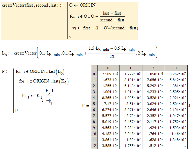

November 21, 2016
Fred already pointed you to the two culprits.
Here is a utility routine to create a vector using the same arguments (first, second last) as used in creating the range and a way to avoid invalid indices in the creation of P.
