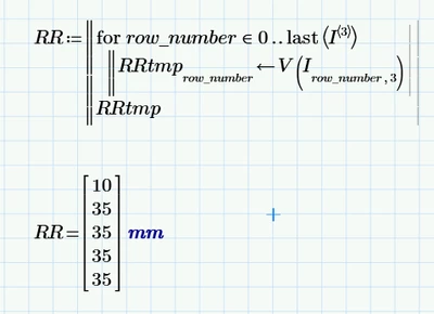

I think you want d1 to be the 5th column of matrix I, the one with index 4 (because counting starts at 0).
Well, here goes:
And read my extended first answer...

i think you understood it wrong
i want R values as matrix, which depends on fourth column of Matrix I.
