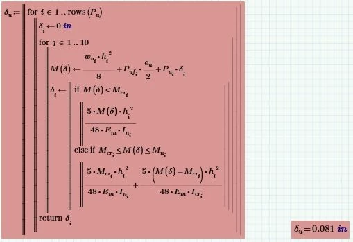

I'm attempting to use a For Loop to complete iterative calculations for multiple cases.  The program that I wrote works fine for single values (scalars), but doesn't work so well with vectors.  Results are coming out as scalar when it should be a vector.  I could use some help.
Werner_EAnswer
You miss the vector index when calling M(delta[i)
Furthermore you have to provide a return value in case M(delta[i) >M.n[i
Try your first solve block (the working one) with the last or last but one values of your vectors to see what i mean.

use subscript i for delta value
polarnaut10-MarbleAuthor
I tried that.  It did not work.

Werner_E25-Diamond IAnswer
