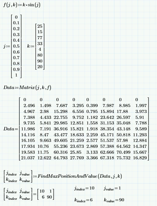

Loops to Find Maximum Value
Find the maximum value from a list of data and  also the value that results in the maximum data.
I have attached a mathcad prime 5 file and pic if you dont have Prime 5

December 3, 2018
Its not clear to me what values you look at to find the maximum.
Are you looking for the maximum of the 11 values which are calculated by
25*sin(j) * 15*sin(j) * ... * 20*sin(j)
as you write about the max value of the "product" (which?).
Or are you looking at the max of the 88 different values calculated by
25*sin(j)
15*sin(j)
In both cases it would suffice to look for the max of the eleven sin(j)  values and you get the max always for j=1
You may use jmax:=lookup(max(sin(j)), sin(j), j)[0 to find out that jmax=1.

Hi
I am after the max of 88 values.
The function may not be sine it could just be an list of numbers
Regards
Werner_E25-Diamond IAnswer
December 4, 2018
So here is one way to get what you are looking for:
File in Format Prime 5 attached.
December 4, 2018
Here's a compact implementation that also works in Prime Express:
Prime 4 file is attached.
18-Opal
December 5, 2018
Elegant
