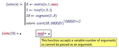

Dec 15, 2022 7:01 AM UTC
Thanks, but Mathcad 15
Dec 15, 2022 7:34 AM UTC
You may use
or even better
because that way you chose numbers from 1 to n (and not from 0 to n-1) which may be more appropriate for a lottery.
A shorter variant without using "max" is
