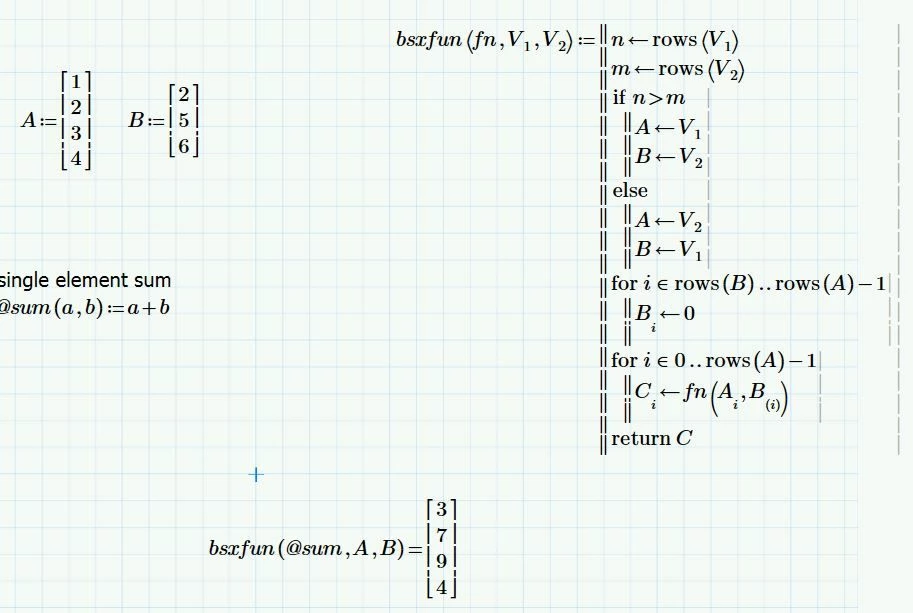

Werner_EAnswer
Jun 30, 2017 4:11 PM UTC

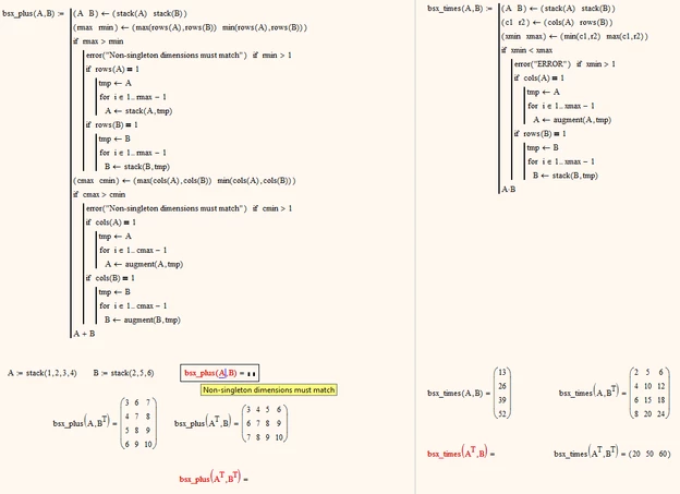

Here are my attempts to duplicate bsxfun(@plus, A, B) and bsxfun(@times,A,B):

23-Emerald I
Jun 30, 2017 2:24 PM UTC
I think this may be a start.  Image here, trying to attach the file.
