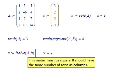

I guess that's why Mathcad 11 requires A to be a square matrix...
and:

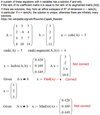

Interestingly:
Apparently Mathcad 11 MinErr first tries to solve the square (upper left) matrix part of the equation. And it doesn't care about the rest...
