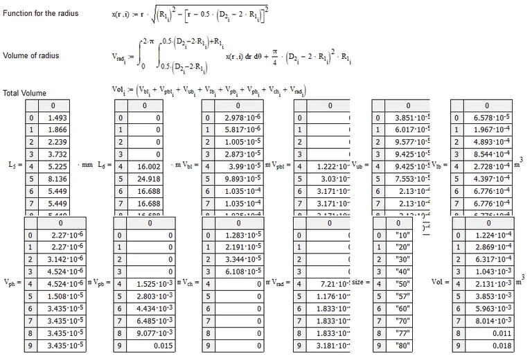

Hi, I'm having an issue where the vectors in the image below con't calculate into a result. The second image is the one where the results should be. I'm using Mathcad 20, so it's pretty old, and the original author of the workbook isn't around anymore. I can't see anything glaring and there was definitely a result from the workbook at some point.
If anyyone can help it'd be greatly appreciated!
Tom

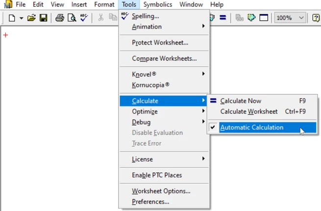

Apr 20, 2023 1:30 PM UTC
You are not using Mathcad 20 but rather Mathacad 15 M20 (M20 ... maintenance release number) I guess, maybe even  MC14 M20
If possible you should attach your worksheet for examination.
My first guess would be that auto calculation may be turned off.
If thats the case, you may either turn it on or press Ctrl-F9 to force the sheet to recalculate.
Apr 20, 2023 1:35 PM UTC

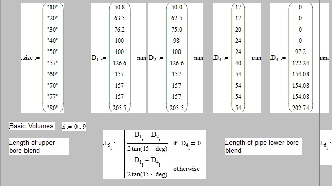

Thanks for the speedy reply! Automatic calculation is turned on. I have attached the sheet below for examination.
Tom

I opened your sheet with Mathcad 15 M050 and I can't duplicate the effect you experience.
When you open a worksheet in Mathcad and auto-calculation is turned on, the visible part of the sheet is automatically recalculated.
So when I scroll down to the end of your sheet, I see this:
What do you see/experience when you press F9 or Ctrl-F9 ?
When you type 2+3= in that very sheet, do you get the answer 5?
