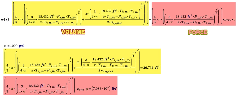

I have been working on this project to evaluate Weight as a function of Pressure, however, I haven't made much progress as I continuously get the error [Replace complex values and NaNs with real numbers]. I've been using Mathcad as a means to avoid coding but at this rate I may need to.

Werner_EAnswer
Check your formula(s).
If x is pressure, you try to add volume and force which of course can't work
 x:=123
w(x)=???
Werner_E25-Diamond IAnswer
Thank you so much, I didn’t notice that the equation was written improperly.

Maybe a place to start (attached)
23-Emerald I
Modified for thick walled pressure vessel.
