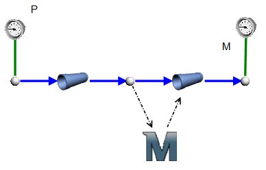

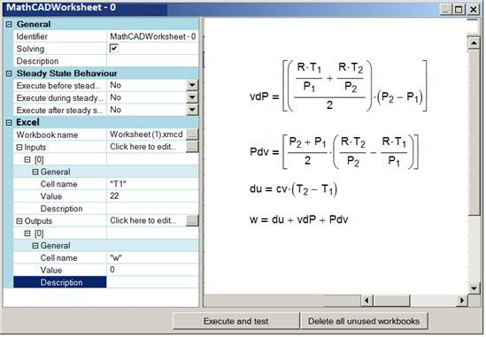

Since I'm not the developer of the flow software, I won't be able to show the exact code, but I can try to explain the way I understand they implemented it. They use .NET for the programming. The image below shows the interface:
The flow software has various components like pipes, pumps, valves etc which one links together and solve for the flow conditions. The MC link they developed enables one to describe the physical characteristics of the custom component in MC. The solver will call the MC worksheet using SetValue (or SetComplex) for each of the inputs defined (like mass flow or inlet pressure). Then it calls Recalculate, and then GetValue (or GetComplex) for the output variables that would then describe the flow characteristics of the compent (like outlet pressure or temperature).
