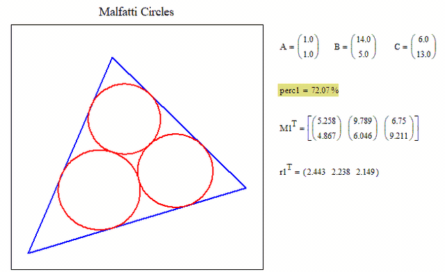

There is a long-serving regular contributor here in the forum who likes to comment on such occasions that a solution without animation would not be a solution.
You may have read it here once or twice (or was it 100 times?). 😈
I apologize as this is neither a particularly beautiful nor a particularly useful animation.

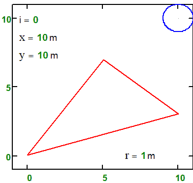

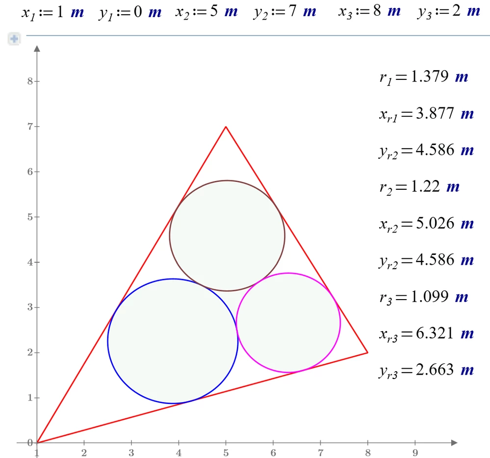

Yes, not each animation is informative and useful.
I hope this is more interesting - an animation of the numeric solution
one connected problem.
Let's wait for other decisions, and then open our playing cards, sorry, our solutions.

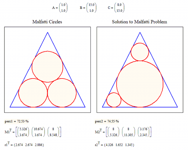

Yes, we have already seen this animation in the past.
Thought that the Malfatti circles would be a nice task for some kind of genetic algorithm for you to implement.
It also would be nice to compare the Malfatti circles to the solution of the Malfatti problem side by side. You probably know that it was proven that the Malfatti circles never are solutions for the Malfatti problem.
The Malfatti problem consists in finding the three inscribed and not overlapping circles with the largest area sum. It can be proven that a simple greedy algorithm does the job.
Sep 14, 2020 8:15 PM UTC
Here you can compare the percentage of the triangle area covered by the Malfatti circles and the true solution of the Malfatti problem (maximum covered area by three circles). It demonstrates that the Malfatti circles never are solutions to the Malfatti problem.
